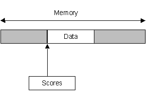

A pointer is just what the name implies, a pointer to a memory location. In the diagram above I have a block of data and a pointer which points at it. In fact, because the locations in memory are actually numbered, a pointer is really a number. The pointer (which I have called Scores) points to the base of a block of data in the memory space. The rest of the memory (the shaded part) is used for other things.
The pointer scores equals the location of data.
